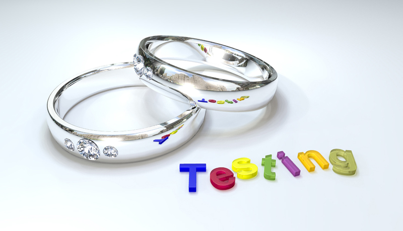

I made this test to check the performance of the CPU and RAM... :(
it took me 15 hr and 48 mins...... :evil:
Resolution : 1500*860 Tiff
No HDRI, just spherical environment.
Dome light (60 omni lights) was used.
2 extra spot lights and 1 rect planar light.
Ambient light turned off.
Reflection iteration: 3
Refraction iteration: 2
AA - High 4X
Mesh - Smooth and slower
Shadow - Soft Shadow
Flamingo is pretty good for product design as it works perfect with Rhino ( they are both very economic :P ) but the rendering speed is frustrating......no real caustic, no HDRI, no GI, no channel rendering.......

文章rryria » 5日 3月 2004年, 13:41
睇唔到... :(

文章rryria » 5日 3月 2004年, 14:18
睇到了,好靚!

文章Siegfried » 5日 3月 2004年, 14:52
atv 寫:發個model file上來比大家rendering 下呀 ?
You're gonna need the latest ver of Flamingo to render it properly, do you have this renderer installed?

文章Siegfried » 5日 3月 2004年, 16:24
......around 6M in memory when I transported it. :o

文章Siegfried » 5日 3月 2004年, 16:42
Use the dome light plug-in to generate 60 omni lights ( different colors and position ) with soft shadow.
A panorama JPEG was used as a spherical environment.
Material : Metal > Silver
Diamond : Please check out the Flamingo tutorial.
Text: Transparent Plastic.
Default ground plane.
