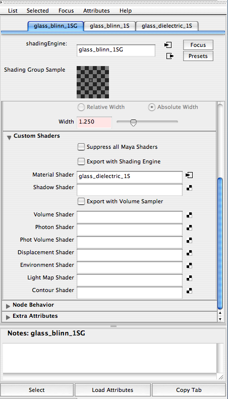

I have some problem of using dielectric to make the glass, the reflection of the glass is too strong. I created a blinn material and dielectric material, then in the blinn shader group attribute, I select custom shader, I link the dielectric material to the material shader. (the screen shot of the setting is enclosed)
The dielectric shader setting is: lor in: 1.65, lor out: 1.65, Phong_Coef: 10
While there is no option to control the reflection in the dielectric material attribute, so I tried to decrease the reflectivity in the blinn attritude. However,it doesn't work. I wonder how to control the reflective.
Blinn shader group attritube
Picture 1.png (72.17 KiB) 被瀏覽 2593 次
