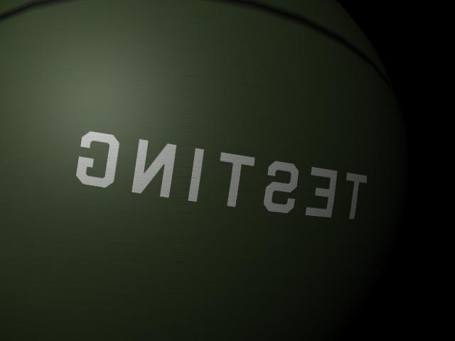

as the title, I have encounter a problem, which the projected texture appears on the both side of the object, while I just want it on the only 1 side of the object.
How to set the projected texture to only appear on the one side of the object?
Thanks so much : )
And this is the back side of the sphere, where I don't want the texture to be projected on.
This is the protected texture on the front side of the sphere.

文章h2o » 5日 8月 2007年, 20:18
convert 做 solid texture, 然後執走背面 d 字 :wink:
文章deshk » 5日 8月 2007年, 20:49
Thanks
I tried to use Edit>convert to texture (Maya Software)
I have made a 2048X2048. Because the object that I'm trying to texture, it is quite a large object.
if I want to keep the label to be very high res on the object, so if the camera zooms very close to it, the label doesn't end up to be very blur. So what should I do?
Actually, I was trying to use layered texture to separate the background and the labels. I have repeated texture (512px X 512px) to create the background color for the object, and I used projected texture to put the the labels. Is it the right way to do it?

文章h2o » 5日 8月 2007年, 22:33
不如用塊 plan, attach or 沿住個 sphere 面 build 出黎, 個 size 就剛剛 fit 你d 字都得姐
然後用 transparency map 偷走唔要既位, 仲有 off 埋 cast shadow :mrgreen:
文章deshk » 5日 8月 2007年, 23:46
系喎 咁會易好多 Thanks so much : )

文章stantang » 6日 8月 2007年, 11:00
There's another way if you don't want to convert your textures. Convert texture is good but if you will have to do that everytime you adjust your texture. There's a flag called "flippedNormal" with the samplerInfo, you can use that with a blendColors to get different textures on different faces.

文章h2o » 11日 8月 2007年, 21:01
我其實有個 post 系關於我咁多年來答過既 technical 問題, 你可以去睇睇
http://www.cg-forum.com/main/viewtopic.php?p=42332
有一篇叫 雙面材質, 你可以去睇睇 flipped normal 既用法

文章h2o » 13日 8月 2007年, 16:44
啱啱再睇多次你個問題..... 你個系完整 sphere 麻? 咁全個 sphere 面既 normal 都系向外, 系唔可以用 雙面材質既做法.
