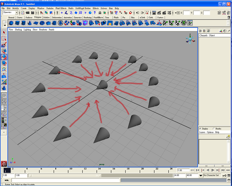

請問點先可以把d Particles指向中心 或 指向指定的方法 ?
EIN
文章: 111
註冊時間: 3日 2月 2005年, 11:10
文章singsinghk » 22日 1月 2008年, 22:57
1.create perParticleAttr directionPP (vector)
2.in creation & runtime expression add:
vector $particlePosition=particleShape1.worldPosition;
vector $origin=<<0,0,0>>;
particleShape1.directionPP=unit($origin-$particlePosition);
3.in Instancer(Geometry Replacement) parts
change AimDirertion => directionPP
*Please make sure the instancer object on +X axis direction.

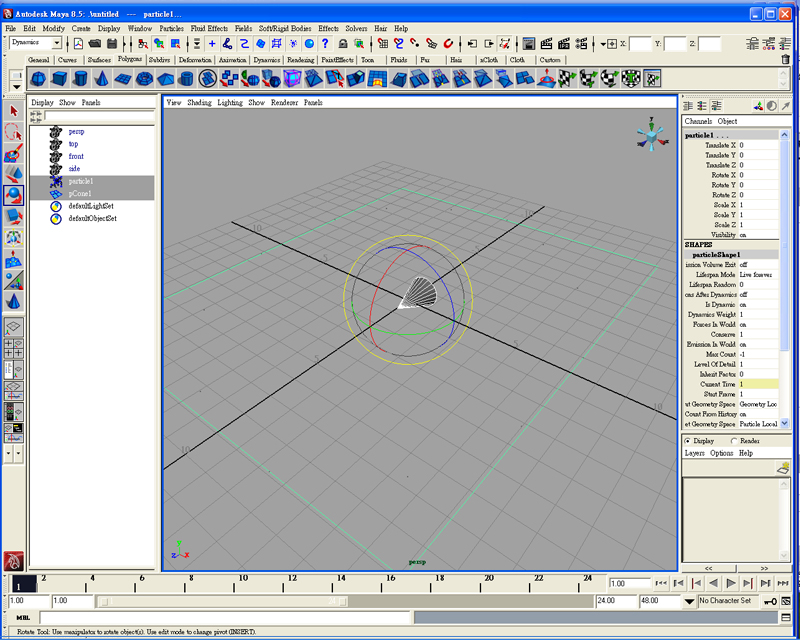

想請教多個問題..像圖1,我用particle tool畫了幾粒粒子後,可否再修改每粒粒子的位置或再增加粒子數量(畫多幾粒)?
EIN
文章: 111
文章stantang » 24日 1月 2008年, 01:46
As far as I know, there is no way to edit the number of particles in a single particle shape that's created by particle tool, but you can edit the position of the particle by using the follow MEL.
particle -e -at position -id 2 -vectorValue 0 0 0;
Change the id number to the id of the particle you want to edit, the vectorValue is where you want to put it.
To be honest, it would be much easier to recreate the particles if you have to edit the particle positions.

文章stantang » 24日 1月 2008年, 01:55
Forgot to mention, you can also use component editor to edit the positions, but redoing the particle would still be easier when you have a lot.
