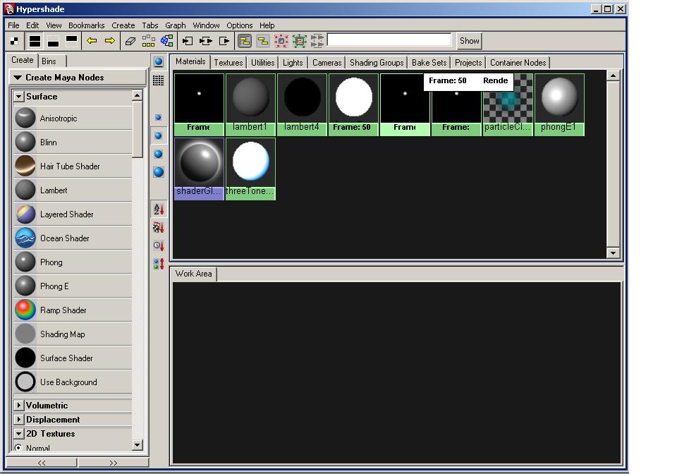

hypershade display error
anyone got the same problem on this?
I'm using XP64, Quadro Fx1700.....

What kind of shaders are they? MR?
I will see if I can recreate the same situation.

hypershade display 個度, mr 同 maya shader 都有, 可能同我個 2008 scene 用 2009 開有關. 不過 close 左個 maya 再開番系冇事.... 但呢個位可以出問題就真系有點兒那個.....
