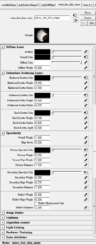

Secondary Specular:
"This" is where you should put any oilish shinyness of a skin. Notice that our nose is always oilly. You may want to crank that up under the nose area, a little under the eye and of course the lip if your character is wearing lip stick or lip gloss. My character for this demonstration is a man. He doesn't need heavy specular on the lip.

Maya shader value:
HapZungLam
文章: 1143
註冊時間: 30日 8月 2001年, 08:00
來自: Vancouver
文章HapZungLam » 2日 9月 2009年, 08:25
Maya shader value:
Feel free to copy my settings. These values fit my light rig that was created by one of my greatest coworker Lester Chung. He basically using one major key light and a bunch of very very dim fill light to light up all the ambien area. Different light rig may apply different values.
To test with your light. I suggest you to test each channel at a time. See how they react before you move on to the next channel. You should turn the value to 0 on every other channel and just adjust the value of the channel that you are currently working on.
