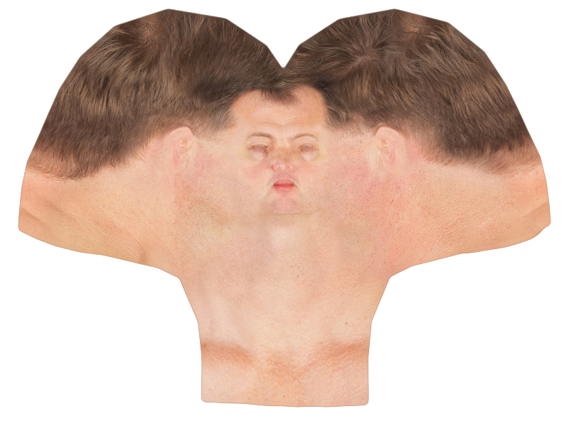

文章HapZungLam » 2日 9月 2009年, 08:16
Diffuse map:
HapZungLam
文章: 1143
註冊時間: 30日 8月 2001年, 08:00
來自: Vancouver
Diffuse map:
This is what the original texture of the head. I map it with photos in photoshop. In my case, I m not going to use this map for any of the channels.

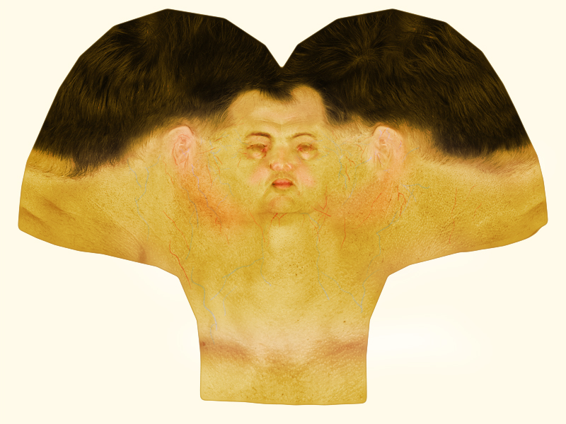

Epidermal map:
HapZungLam
文章: 1143
來自: Vancouver
文章HapZungLam » 2日 9月 2009年, 08:17
Epidermal map:
As I explain perviously to use epidermal as the fat layer of a skin. What is inside the middel layer of the skin should include in this map. eg: fat, different layers of veins, differnt thickness of fat, some fat may blend into some of your muscles, etc. The more detail you give to this map will get you better result.
In my map, I did not mono tone my diffuse map into yellow. Try to avoid having grey value. If you want to have some dark area, make it more saturate when you tone down the curve.

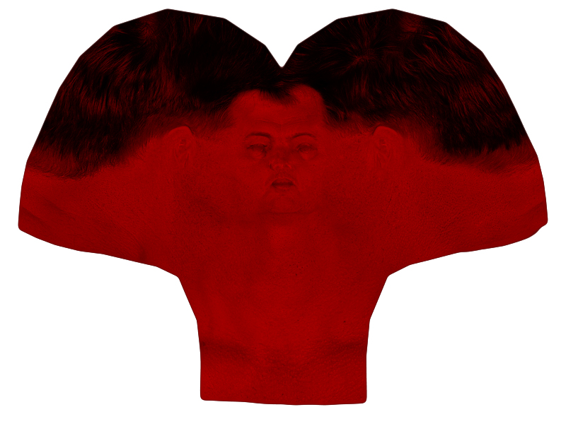

Subdermal map:
HapZungLam
文章: 1143
來自: Vancouver
文章HapZungLam » 2日 9月 2009年, 08:18
Subdermal map:
This is the muscles and bone layer. More or less is just pure red. I can add more variaty to it but I find it un-noticable. So I just use my diffuse map and monochromatic to red. This red map will appear on very outer each of your skin. You will not see anything under direct light.

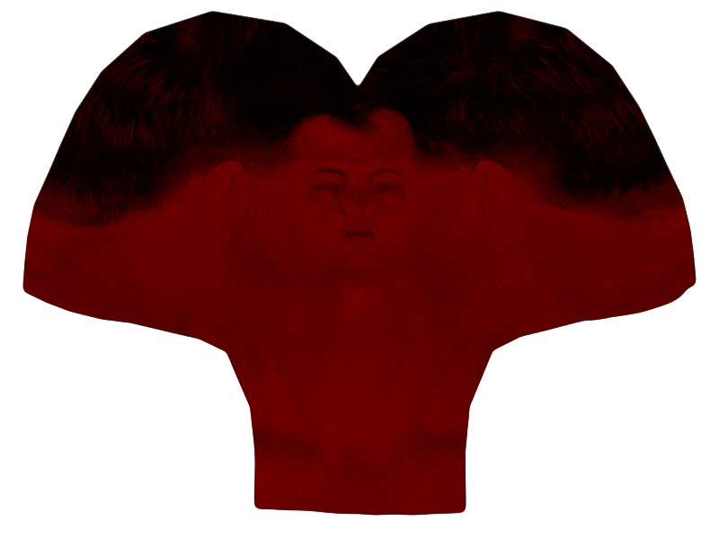

Back Scatter map:
HapZungLam
文章: 1143
來自: Vancouver
文章HapZungLam » 2日 9月 2009年, 08:19
Back Scatter map:
This will only show up when a light his shining from behind. Notice that if you give too high value to this channel will make your object looks like wax. A lot of user feeling happy to crank this value up because they don't see the effect. But this should just be a little touch ups on the corner of the ear and nose in my opinion. Over done it will appears waxxy looking.

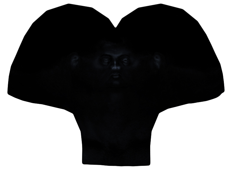

Primary Specular:
HapZungLam
文章: 1143
來自: Vancouver
文章HapZungLam » 2日 9月 2009年, 08:21
Primary Specular:
Warning: Do not brighten your specular on skin ever. Notice that the skin is actually a pretty dull material. The little specular you see is almost react like regular diffuse. Even the lip should be not much different from any other places of the skin. People see specular on their lip either after they lick themselves or wearing lip gloss. Do not over done on the lip.
As you notice my specular map is really dark and having a little blue tone to it. You may make it pure de-saturate but I found a little blue will make it contrasts nicely with the skin.
