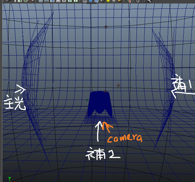

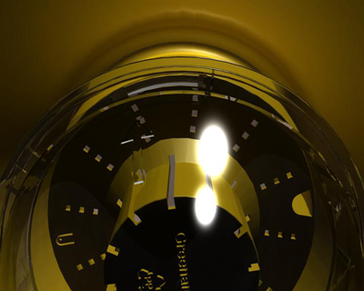

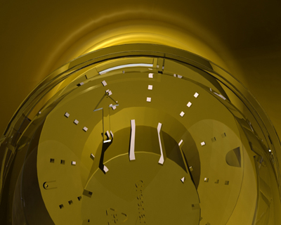

想請前輩指教,
我做緊個 product rendering, batch render前 係重點keyframe "render view" preview過無問題,
但係 batch render出黎, 唔夠"render view"光
*Camera 有底射上去, 中間隔住左個 transparent 既 model,
Featyres 開左: Raytracing, caustics, final gathering, ambient occlusion
唔知有咩可能既原因引致呢種問題呢?
萬分感激

再 check 多一樣野, 地下 floor & 補光既 plane, 係唔係完全重疊?

唔係, 補光果塊低D,
但係個floor, 我用左single size, 咁會唔會有影響呢?

我諗你係指 single side 吧.... 我都會用呢個 attribute, 只要 make sure 你見既 view 係正確就得
補光係低D, 咁中間夾住既 floor 係咩 material? 正常係會檔左光 bor..... 通常地下既 bounce light 已經當係補光, 好少再放多一個光源喺下面, 就算係燈箱都會推光個 floor ^^

就係因為batch render 見到咁黑...所以先特登叫下睇下work 唔work...
果個地板好似用左 lambert 定 blinn...
奇就奇在...佢render view一個樣...
batch render from 1- 1400 frame 又好黑
但係直接由果刻開始 render, about 400 -500 又無咁黑...
(camera motion: from front and goes to its buttom and looking upwards back to front )

哦.... ic.... 用 mentalray render, 最好用番 mental ray shader, maya shader 係會有各種奇怪問題架
