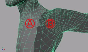

polygons建模怎會變成這樣?有兩種顏色,不能正常顯示,請問要怎麼解決?

I think it is the problem of the "normal" in your polygon. You can check it whether it is in the right direction and reverse them when needed.
hope this help!

請幫忙看看問題在那?我是在修改edge和merge vertices變成這樣的,thanks...

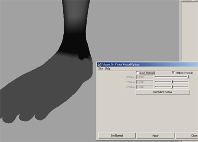

文章mayaBug » 11日 4月 2004年, 02:17
Edit Polygon > Normals > Set Vertex Normal >..click " unlock Normals" ,then apply
after click" unlock Normals" ,then apply

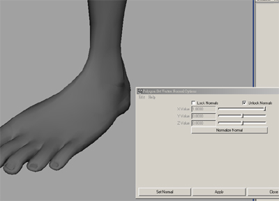

before...
