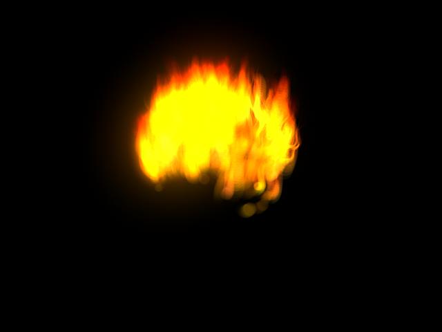

文章eidosyam » 5日 7月 2005年, 02:43
make painttable for nurbs sphere
Get brush
click fire in visor ,
close visibiltiy :o
i try try...

文章stantang » 5日 7月 2005年, 03:02
guyfire 寫:怎樣在 sphere 放“火”?
貼 texture or ......
Select the sphere, go to Dynamics-->Effects-->Create Fire. Then you can change the color ramp, etc... This is the easier way.
If you want more control over the shape of the fire, you can model the fire and make it softbody, apply some forces to it, then map a fire texture on it. Here is a tutorial for that: http://www.thegnomonworkshop.com/tutori ... andle.html
IF you don't like any of the above method, try Maya Fluid. Like h2o said, go to Visor then click Fluid Example tab, there's a folder called Fire, right click on one of them to import. Beware that, Maya Fluid canbe both easy and difficult, and the feedback is slow if you have a slow machine...

文章guyfire » 5日 7月 2005年, 19:18
謝謝各位的回覆!
各位所述的方法我也試過,但未達到的心中的“火”。
最接近的方法是用 Maya 中的 Creat Fire ,但這效果的底部過散,想要有較實的球型感覺。
不知可否做到呢?
