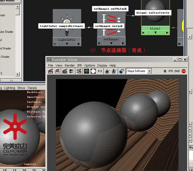

some questions
文章eidosyam » 29日 7月 2005年, 17:35
why do it need connect to camers of persphape???
i try that use light info connect to setrange then the setrange value X =0 ?? why??
thank you for reply. :P
eidosyam
文章: 43
註冊時間: 4日 12月 2004年, 00:55
文章stantang » 29日 7月 2005年, 23:35
connect the world matrix of the cameraShape to the world matrix of the lightinfo node.
