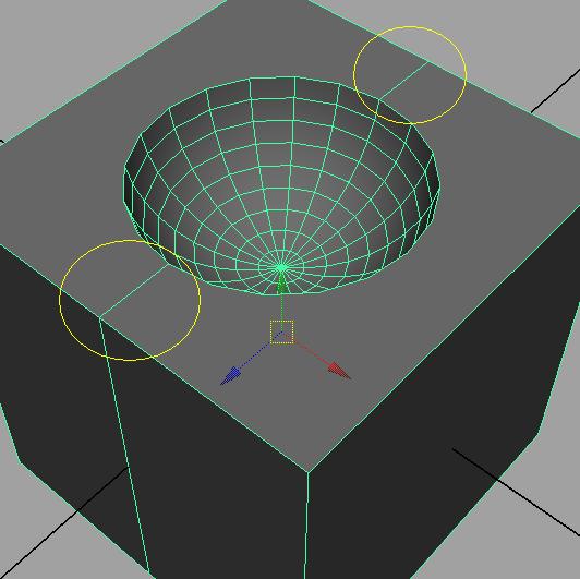

請問各位, 如何在polygons - Cube 面上加一個半圓的凹位

將一個cube和一個circle放好位,
用polygon>boolean>diffence
要留心兩者之間要有線相連
fig

shape 寫:...要留心兩者之間要有線相連
Hmm... may I ask why? :roll:

文章zaku » 24日 2月 2006年, 19:34
The model after Boolean command is a bit unstable. The model may give you some strange results of further commands subsequent to polygon Boolean command.
Pls try to "delete history" after your Boolean operation. It may help.
If possible, pls avoid to use it.

文章shape » 24日 2月 2006年, 21:53
stantang 寫:
如果唔系個塊面會有error,
例如唔可以再split.

文章stantang » 27日 2月 2006年, 10:04
shape 寫:
stantang 寫:
如果唔系個塊面會有error,
例如唔可以再split.
as zaku said, you can clean up the model by just deleting the history. The good thing about poly is you can pretty much do anything to it and still being able to fix any problem very late down the road.
