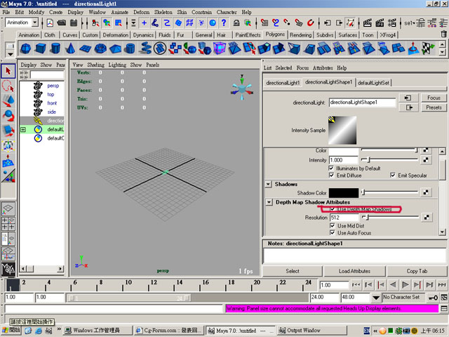

leovirginia 寫:請問點樣整shadow?
即系 e.g. 有一個人, 地上有個個人gee shadow.
以前 試過跟書 and web tutorial... click Depth Map Shadow or Ray Tracing Shadow...
Depth Map Shadow 應該系個lighting click返 Use depth map shadows 就有架wow, 你try try

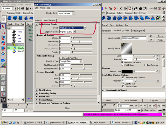

如果仲系唔得試下系個render option check 埋 production quality

文章leovirginia » 17日 3月 2006年, 11:14
o... Rendering gee Quality 原來會 giv impact to lighting ga?..
ok.. let me try a bit

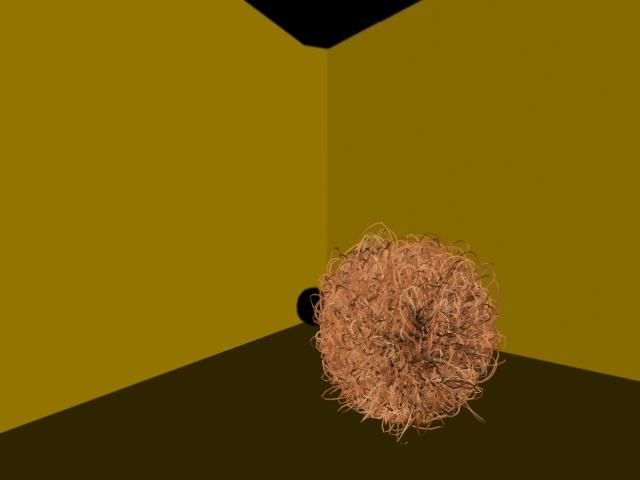

文章leovirginia » 17日 3月 2006年, 12:34
O, the shadow works now. prob I've made some mistakes in the rendering global. haha
But Now I find out that it juz got shadow on the Object, itself. but not on the fur. c the Image ...
Does Ny1 kno y?
