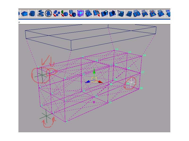

文章leeho » 22日 5月 2006年, 22:42
:mrgreen: 跟教程寫 , 但不成為何 .....有無高人指點 :mrgreen:
如下..
float $position1[] = 'getParticleAttr -at worldPosition fooShape.pt[1]';
locator1.tx = $position1[0];
locator1.ty = $position1[1];
locator1.tz = $position1[2];
float $position7[] = 'getParticleAttr -at worldPosition fooShape.pt[7]';
locator2.tx = $position7[0];
locator2.ty = $position7[1];
locator2.tz = $position7[2];
float $position19[] = 'getParticleAttr -at worldPosition fooShape.pt[19]';
locator3.tx = $position19[0];
locator3.ty = $position19[1];
locator3.tz = $position19[2];
文章leeho » 22日 5月 2006年, 23:09
:roll:
expression -s "float $position1[] = 'getParticleAttr -at worldPosition fooShape.pt[1]'; \r\n\r\nlocator1.tx = $position1[0]; \r\nlocator1.ty = $position1[1]; \r\nlocator1.tz = $position1[2]; \r\n\r\nfloat $position7[] = 'getParticleAttr -at worldPosition fooShape.pt[7]'; \r\n\r\nlocator2.tx = $position7[0]; \r\nlocator2.ty = $position7[1]; \r\nlocator2.tz = $position7[2]; \r\n\r\nfloat $position19[] = 'getParticleAttr -at worldPosition fooShape.pt[19]'; \r\n\r\nlocator3.tx = $position19[0]; \r\nlocator3.ty = $position19[1]; \r\nlocator3.tz = $position19[2];" -o "" -ae 1 -uc all ;
// Error: {float $position1[] = 'getParticleAttr -at worldPosition fooShape.pt[1]';
// Error: Syntax error //
// Error: float $position7[] = 'getParticleAttr -at worldPosition fooShape.pt[7]';
// Error: float $position19[] = 'getParticleAttr -at worldPosition fooShape.pt[19]';
文章Lik » 23日 5月 2006年, 00:00
hey, u use a wrong quotation :!: when executing a command in Maya, the quotation should be " ` ", the charater above the "Tab" key on the keyboard. U have used sth like " ' ".
Also, try using "particle" command when queue particle data, such as :
float $position17[] = `particle -attribute velocity -order 17 -q particleShape1`;
This will run faster compare with yours, especially when the particle count is huge.
Lik
文章: 6
註冊時間: 22日 5月 2006年, 23:10
文章leeho » 23日 5月 2006年, 00:46
Lik 寫:hey, u use a wrong quotation :!: when executing a command in Maya, the quotation should be " ` ", the charater above the "Tab" key on the keyboard. U have used sth like " ' ".
:mrgreen: :mrgreen: 非常感激 :mrgreen: 原來是自己按錯符號 :oops:
現在particle 和 locator 溶合了 , :mrgreen: 感謝 ! thankfulness
