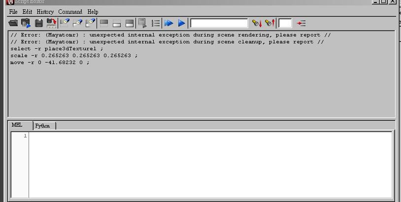

我building 完之後同洛左texture 之後,mayasoftware 無出問題,但用mental ray 來render,佢完全唔render,而且系mel 出左呢一句
// Error: (Mayatomr) : unexpected internal exception during scene rendering, please report //
// Error: (Mayatomr) : unexpected internal exception during scene cleanup, please report //
我試過select export 呢個object 一個新file,delete history及Freeze Transformation,都出現呢個問題
唔知點解決好,請各高手幫忙

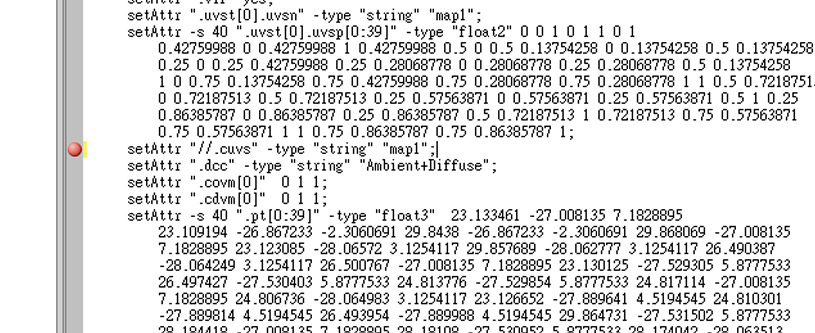

解決了 :D
我是edit 入面的script。
我看見好多呢d value 名系無comment "//"的,但呢一行會有
之後我delete 了,之後render 時,沒有問題
