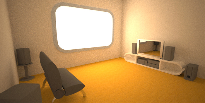

Take a look at the attachment (original 2055*1032 px), I rendered it for 870 mins with S.L.25, but I just stoppped it around 860 min as I cannot take that long, the rendering is still VERY grainy. :-|
I'll give it a try during Saturday and Sunday, for a 48 hrs rendering marathorn. :wink:

文章Wolf » 21日 6月 2005年, 18:25
870 min! I would've killed the bastard when it entered the 30 min mark and showed the first sign of that level of grain -- and remember grains look even worse in moving images. Notwithstanding the pretty pictures in their gallery, this type of rendering speed is unacceptable for any serious work. I think currently the only viable solution for fast GI is MR.
