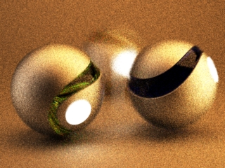

文章Siegfried » 15日 6月 2005年, 18:23
30 mins of grainy rendering. The center spot is an emitter.
The green zone are in glass material.
Result - No eye see.

文章chatho » 16日 6月 2005年, 02:40
Siegfried 寫:Result - No eye see.
我見maxwell 個forum o的人個個o的圖ren廿個鍾都視作等閒事...
o個o的就 have see head 啦~

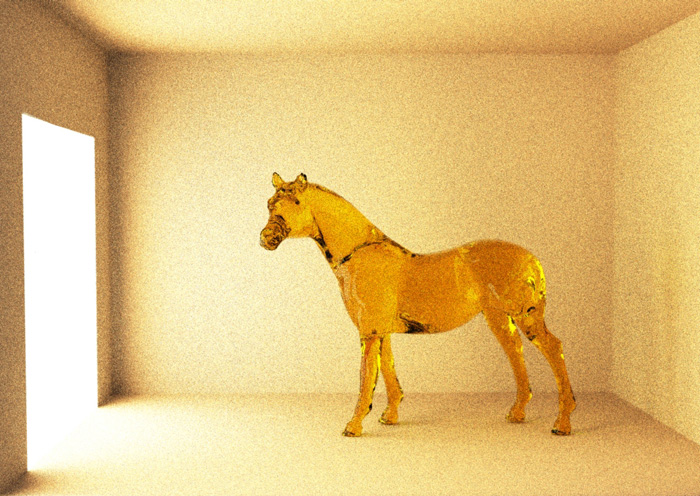

文章Siegfried » 17日 6月 2005年, 12:57
As I don't have "Neatimage", so please bear the noise. :wink:
Rendering time : 1h 10m
Px :1024 X 768
Shutter : 1/60
Aperture : f/12
Sampling Level : 15
Threads : 4
Bounce : 8
Sky Dome : 30 - RGB all 253
Additional Lighting : 1 Surface Light, Cool White, 200W.
Layer : All on
Burnt : 0.7
Gamma : 1.0
image 111 copy.jpg (170.23 KiB) 被瀏覽 12032 次

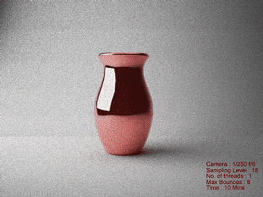

文章Siegfried » 17日 6月 2005年, 18:14
The beta verion is released, but there are still many bugs, especially to Rhino (OMG), material cannot be applied at all if you wanna run the rendering. Next Limit (NL) is gonna to upload the patch to fix the problem in these couple days.
In the mean time I'm running some comparison test on the time consumption. A challege to my office computer to keep running for several days. :mrgreen:
