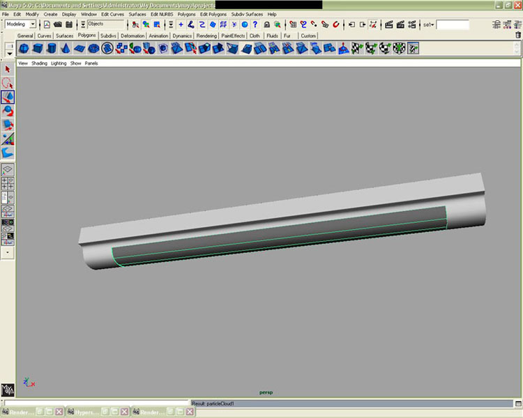

怎樣令綠色部份發光來照明房間呢?
Can I NOT to create Light?

Create an area light about the size as the surface, this is used to light the scene, then bring up the incandescence and glow for the shader of the surface.

文章HONG KONGer » 29日 8月 2005年, 14:53
stantang 寫:Create an area light about the size as the surface, this is used to light the scene, then bring up the incandescence and glow for the shader of the surface.
So can I light up the scene without creating a "light"?
我試過incandescence, 但只有光管發光, 房間其他東西仍然是黑色一片.
I also tried the "Glow Intensity" option but it doesn't make a different.

喂....你條光管...想發光部份....咪俾個自發光材質佢....
同時間...如果想因此照亮埋場景.....收埋支真的的"light"光源在光管內咪得咯.....
:roll:
And 1 more thing, remember to take off the "cast shadow" in ur selected model
