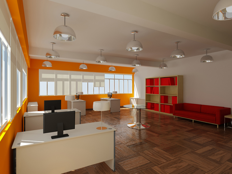

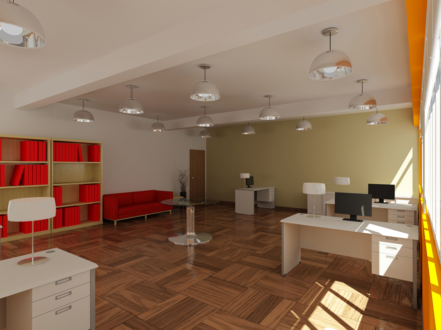

這是我用 vray 做的一個練習, 出來的效果好像不太好, 各位可否給我一點意見 ??

I think the render is fine, the problem is your textures, materials and scale of the objects. The table has no specular, the wood tiles are too big and the textures look off, the chrome/stainless steel material look too shiny, the scale of the bookshelf looks off and the red big books certainly look very strange.
You should also rethink the layout design. At this stage, it looks to me that you put many downloaded models into one space. I definatly can't picture the very ordinary office table in a room with some designer looking lights, a round glass coffee table in the middle.... oh and the bright orange-yellow wall 8)

thanks for your comment, agree with you that my textures and materials is very bad. all of the model in the scene are built by myself, besides the pendent lamp and the plant. this strange office is actually where i worked here ... :cry:.

地下 d wood 好卡通, bump 得太勁了
d 燈膽有無開的?但好似發白咁,
陽光咁勁但窗出面好暗...

大部分 shader 好 flat, flat 既原因系冇左立體感. 雖然 GI 計左出黎夾角有少少暗位, 但你見成個台面, mon 面系 flat 架.
你漏左樣做 shader 三大 elements 之一 - specular or reflection. 現實 object 大部分都有 reflection, 而且 reflection 同 diffuse 系相對既. 就台面黎講, 我會 set 番 0.1 至 0.2 既 reflection with scatter (即系打散左既 reflection, 可以用 少少 bump 打散).
chrome material 既 reflection 太強 (我見系 reflectivity 100%), stantang 都提過, 我想講既系現實系冇 prefect mirror 呢樣野, 實驗室做出 reflectivity 最大既 mirror 都系 99.7%, 現實既 mirror 做到 97%以上已經賣好貴, 所以 cg 做呢類 material 最多都系 90%.
