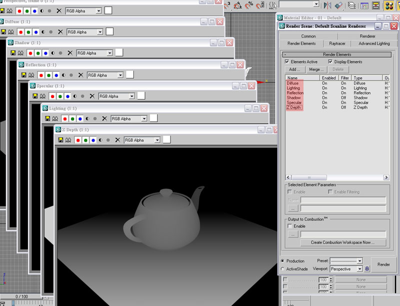

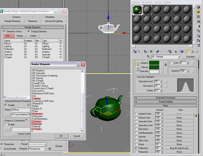

文章stantang » 7日 6月 2008年, 13:14
kinnng 寫:It really let me understand the process for comp
especially use the mask pass with red channel.
would H2O teach how we can do the pass in 3dmax more efficient?
Since I always render it by change many materials to make all the pass layers
Just use the render elements function, the pass rendering function is much easier than Maya. To create the mask pass, just select the objects and change their object ID under object properties, then add a object ID layer in render elements.

文章sobig » 9日 6月 2008年, 13:38
mate..here, we go...
u can do that in F10 > Render Elements Tab
文章sobig » 9日 6月 2008年, 13:41
and eventaully, you can get these layers for compositing in AE.
i prefer u can do that with Final Render. it is much better.
