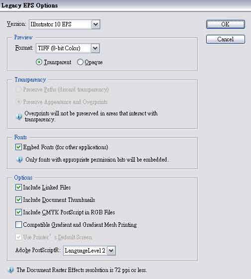

我有個AI file, link左 PSD images,
我想export做 EPS format做output printing.
我tick左 include linked files,
佢export時, warn我, 話" can't save illustration"
我唔tick include linked files, export冇問題,
有冇大佬知道wt happen?

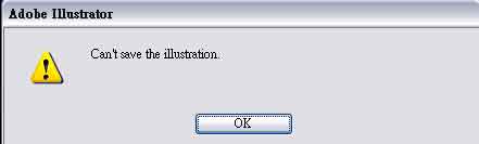

文章sobig » 24日 4月 2007年, 23:37
the warn msg....
Illutrator file save as eps
文章cottonsan072 » 26日 4月 2007年, 08:23
I have seen this problem few times before. Most of the time are the artwork are way too complex, file size too large or machine runs out of memory.
There are few ways to get around the problem.
1) Rasterize the Image internally in AI and save the file again.
2) Instead of EPS, save the file as PDF
3) Instead of importing the PSD layer file, save the import image as a flattened tiff and import to AI again.
See if they work
