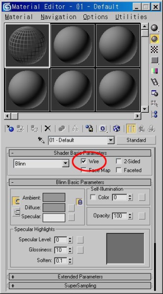

I fount it how to hide the wirefame by render "Sceue > render > Options", thanks for your help, but i want to know one more thing . how to hide the wirefame i want ? just cos it show all the wirefame to me, and i just only want to see way wirefame, not under wirefame, please help ! ^.^

If my understanding is correct, you just need to do the normal render but use the material method to do the wireframe rendering. Check the "wire" checkbox.
