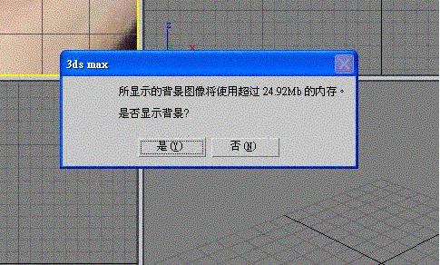

文章maksimhung » 26日 4月 2006年, 12:44
不知道為什麼會這樣?
我選"是"會好運算得好慢!
請幫幫我!

文章stantang » 26日 4月 2006年, 13:31
maksimhung 寫:不知道為什麼會這樣?
我選"是"會好運算得好慢!
請幫幫我!
reduce the size of your image...

文章xam » 26日 4月 2006年, 18:53
you are zooming too close. 3ds max needs to do the interpolation (scale up) of the background image, and that will EAT UP LOTS of RAM....
Try use a plane and map the image onto that plane. Increase the Self-Illumination to 100 so the lighting in the scene will not affects the image on the plane so u will see it clearly anytime. (remember to turn on the show map in viewport button in the material editor.)
