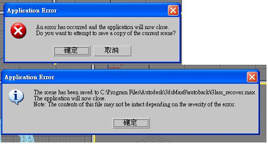

文章siufei » 27日 2月 2007年, 01:31
每做一陣下野就出圖中的waning -.-" 之後就成個max關了

文章sobig » 27日 2月 2007年, 10:33
8) actually, i love this warning msg so much.
it is difficult to avoid facing this problem(死file) if you are using 3ds max.
in your case, you can go to program file/autodesk/3dsmax8/autoback. you will find your recovery file.
the only way you can do is to save various versions for you files. then, you can get back to last step without too much pain.
文章siufei » 27日 2月 2007年, 12:05
現在完全做不到野 -.-" 滑鼠碰一碰其中一個veiw就咁.....

文章sobig » 27日 2月 2007年, 13:03
try to open an new sense in max.
then, merge your whole objects into your new scene.
your die file problem should be fixed. :)

文章sobig » 27日 2月 2007年, 13:06
especailly, this involves other external objects in your scene.
you should do a clean up progress b4 you start your project.
you can change all objects to be Edit poly first.
then, clear the shaders / apply a default shader to all objects.
and rename the objects by max rename modifier.
after that, you can play with your project.
it is a habit to avoid die file. :)
