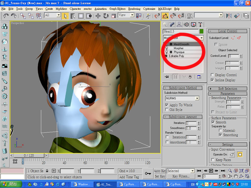

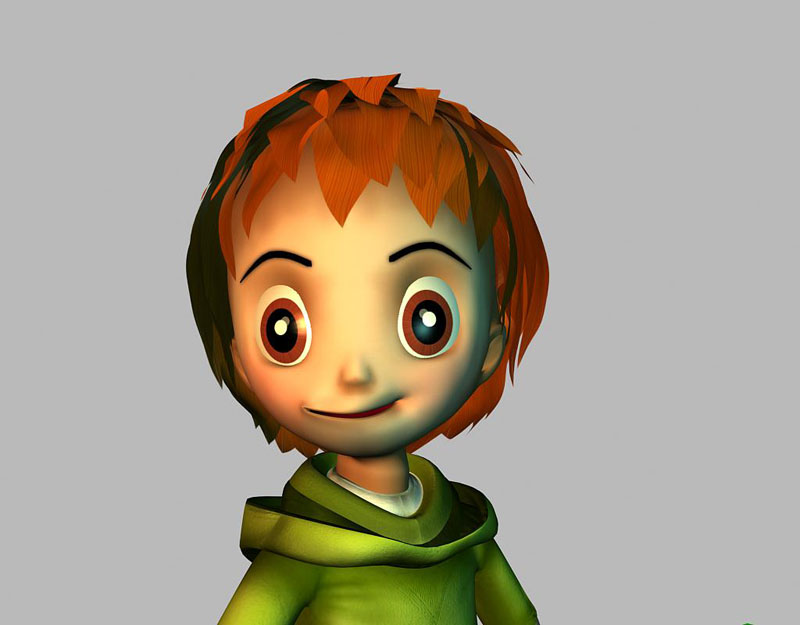

想問正確系咪先做好唔同表情既頭,然後add morpher -> pick object from scene 去揀番表情果D頭. 然後先加 physique (我個頭同個身系分開落 physique)
我跟以上次序做,系可以做到表情,但系一將個頭左右擰,個咀就會變型....何解..??
正確的表情
Face 02.jpg (120.34 KiB) 被瀏覽 13329 次
擰頭之後變型既咀

文章siub » 14日 1月 2008年, 23:06
I'm sorry. I tried to add Physique first and then add the Morpher on the head. After that, when I rotate the Bip01 Head, the head will not go with it.......
Did I do something wrong? Thanks in advance

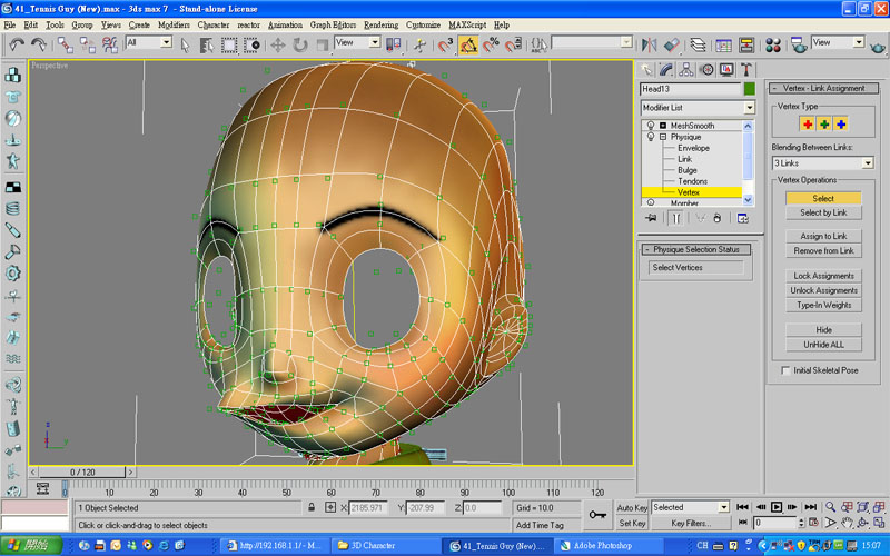

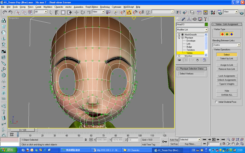

文章siub » 15日 1月 2008年, 16:30
I have already assigned all the vertex of the head (except the neck) to the head link with "green" vertex and "no blending".
Any other possible cause.....? Thanks in advance.
向右擰
向左擰

文章riccardo1978 » 16日 1月 2008年, 09:22
before you assign the vertices to the head bone as no blending (green), u will need to remove all blending (red) vertices assignment. because in physique a vertex can be both rigid and deformable @ the same time.

文章siub » 16日 1月 2008年, 16:53
riccardo1978 寫:before you assign the vertices to the head bone as no blending (green.....
I have done this before. I do it once again and now the mouth will not deform when the head turn right and change a facial expression. But when the head return to normal positon and the facial expression change back to the orignal one, the head deform again.... :(
Is that possible that it is related to the Xform? I'm not sure what to do with this.

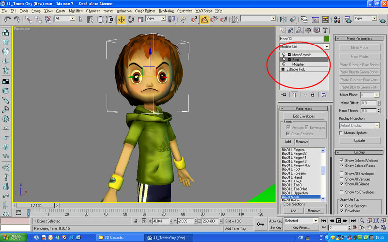

文章siub » 16日 1月 2008年, 19:07
I finally made it with sobig's suggestion!!!!
It is strange that no matter what I tried on Physiques, the head will deform in all the case.... But for Skin, one-take is ok.
I set the vertex soley affected by the head bone. I can make various facial expression and rotate the head at the same time, without deforming the head la!! No more Eddison Chan la!!
Thanks all brothers help in solving my questions. I can go on with my assignment la!!!
好開心,多謝各位~
唔再似陳冠希.....
modifier既次序
