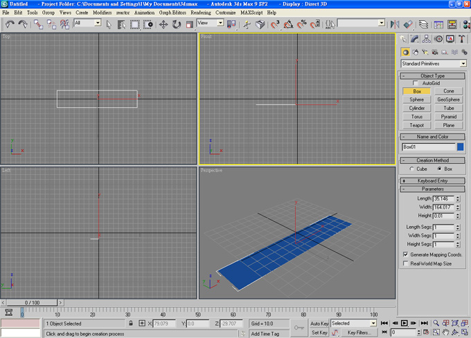

文章lcm » 2日 8月 2008年, 21:53
想請問,我在3dsmax 9 中的object type 到,在back, front, left view...中拉任何一個形狀出來的時間,為何出來的object,都會系得top view時拉出來的方向,
是否preference setting 有問題呢??

文章sobig » 3日 8月 2008年, 13:06
i guess you applied "Position Constraint" as your default Position Controller. thus, the object you created is also placed in (0,0,0). also, you cannot move it by Gizmos.
pls do the following steps...
1. select the object that you created.
2. go to Motion Panel (right column tab)> Parameters
3. under "Assign Controller", select "Transform: Position/Rotation/Scale"
4. go to "Position: Position Constraint"
5. select a little button under the "Assign Controller" tab.
6. pop up a window calls "Assign Position Controller"
7. select "Position XYZ"
8. press "Make Default" button on the right side.
after those steps, you can create and move you objects whatver you want. hope this help. :)
文章lcm » 5日 8月 2008年, 23:38
都系唔得 :cry: 鏟左個3dsmax再裝,都系一樣唔得,仲有無其他方法 :-|
