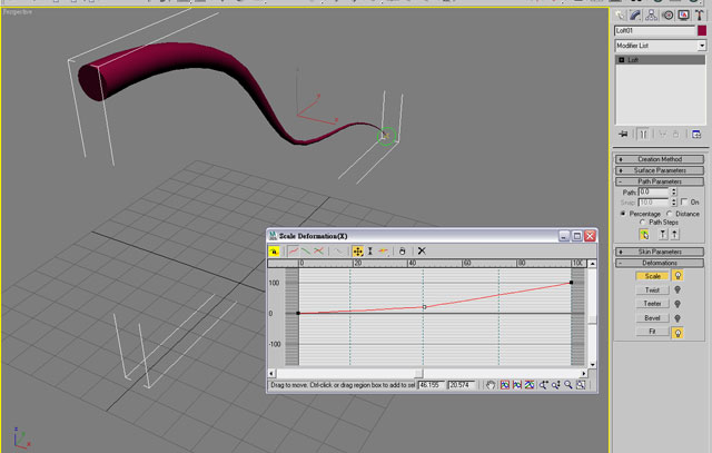

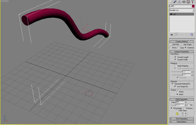

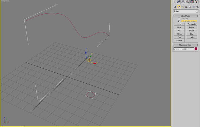

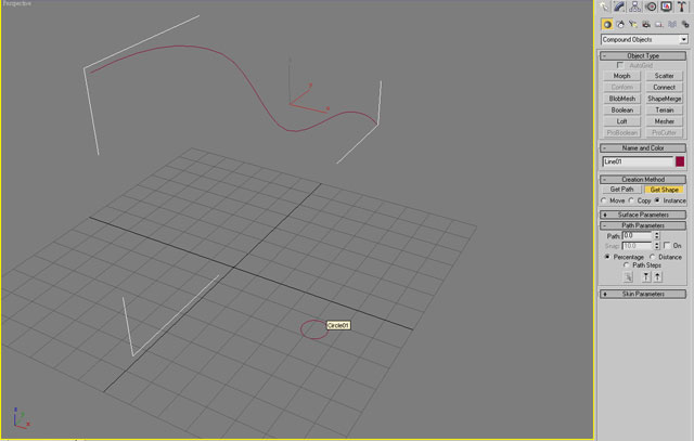

文章sobig » 13日 2月 2010年, 18:52
你可以試下d老炮方法, 簡單易用...
1. Create a line and shape.
2. Apple "Loft" modifier to that line and shape.
3. You will get a shape of root or branch
4. Set key frame of the lenght or radius of the branch.
5. You can do that sort of animation like growing tree or branch.
Once, you want a seed become a flower.
you can try to do it with Morpher modifier.....
these are the most easy way, hope this hope.
pls see my image attachment
文章sobig » 13日 2月 2010年, 18:53
take a look...........
文章sobig » 13日 2月 2010年, 18:54

文章sobig » 18日 2月 2010年, 14:10
wc430430 寫:THX~花朵慢慢生長,花瓣反出黎~咁我系咪set骨比佢好= =
花瓣反出來, 我會用FFD modifier, 去key個shape, 同key埋個scale, 就可以扮到
