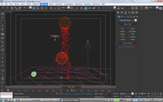

已經做好左個file,but render 唔到d 粒子
希望高手解答

pls print screen your viewport....
cannot dl your max file
文章sivin1015 » 5日 6月 2009年, 12:14

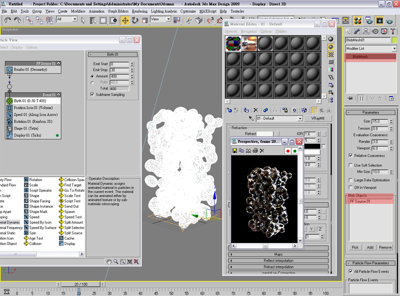

For "我有用blobmesh add 左落去 pf source"
When you use BlobMesh with a particle system, a metaball is created at each particle's location. The size of the metaball is determined by the size of the particle.
1. Create a particle system, and set up its parameters to animate the particles.
2. Click Create panel > Compound Objects > BlobMesh, and click anywhere on the screen to create the initial metaball.
3. Go to the Modify panel. In the Blob Objects group, click Add. Select the particle system. A metaball appears at each particle in the system.
4. If you have added a Particle Flow system to the blobmesh and you want to create metaballs only for particles in specific events, click Add on the Particle Flow Parameters rollout to choose the events from a list.
i captured the viewport for you.
pls check.

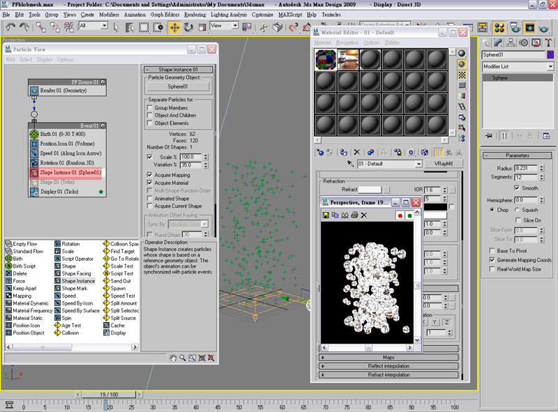

For "要點樣先可以用Sphere add 落去 pf source"
1. Create a PF
2. Drag "Instance Object" operator to your PF.
i also capture my viewport for you.
文章sobig » 21日 6月 2009年, 18:01
and finally....Instance Object will take you a long time to render.
bear in mind.
it seems to be stopped but it is still rendering somehow.
