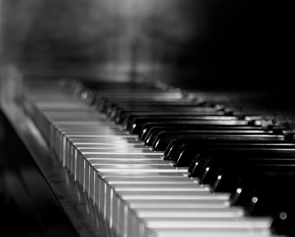

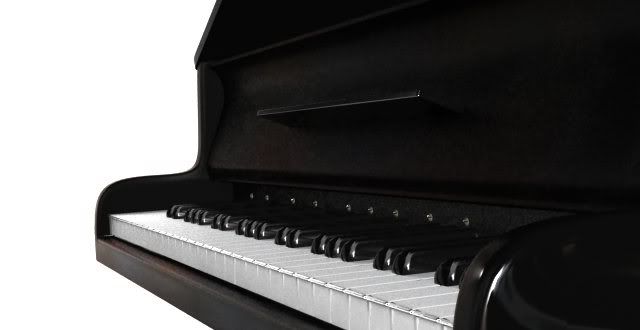

This is the image reference with nice DOF which I found useful for my practise

文章aniOcean1204 » 24日 8月 2009年, 02:28

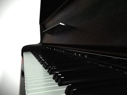

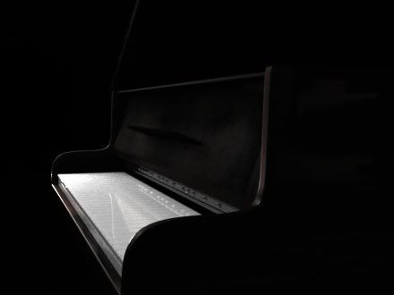

I tried to render a still image first to see how the lighting and material come up. (It takes long time to learn each setting in vray for the beginner)
Testing 1
Testing 2

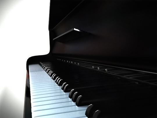

Use falloff for the reflection
Render the image and use it as the reflection for the black key. But it looks a bit fake for the same reflection on every keys
I found hard to have a good result on the reflection of black and white key. And the HDRI reflection of the side view look a bit fake too.

文章aniOcean1204 » 26日 8月 2009年, 02:14

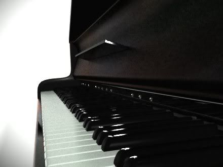

I added some light for specular part aorund the black keys, it is hard to render sth like the reference.
1.
2.

文章h2o » 26日 8月 2009年, 02:45
Depth layer 有兩種, 真 or 假
真既系指 zdepth.... vray or max 點做要你自己搵下資料, 因為我唔識 max
假 depth 就系一個 黑到白既 gradient, 由個 top view project 落去, 出黎既效果就好似 fog 咁
Shader 方面
呢種 material 最好跟番現實一樣有 Fresnel reflection, 我唔記得個做法系咪 reflection 度要有 fall off map, 之後先可以著 Fresnel 呢個 option
Lighting
你見到個 piano 既 highlight 其實都系 reflection, 只要你放塊白色既板做 reflection, 放啱個位置就會出到一條白邊咁樣既 highlight
hdr 圖同你個 reference 既 lighting setup 都唔同, 你唔一定要用 hdri, 你自己 setup 個 env 做 lighting 一樣都系 high dynamic range
我唔知你呢張 reference 邊到黎, 但我估影相既時候, 後面系有窗口 or soft light. 其他 detail 位黑哂睇唔到, 有可能屋企影之後 tune 黑, 亦有可能系 studio 周圍黑哂, 靠自己打燈. 個 highlight 上面有一點 bloom 既光點, 一系窗口既太陽, 一系soft light 中間個點光位.

文章sobig » 26日 8月 2009年, 12:04
aniOcean1204 寫:I added some light for specular part aorund the black keys, it is hard to render sth like the reference.
1.
2.
what i suggest is to use Default material. It has a specular control for your material. Default material also can use vray reflection parametar.
also,you can add a gradient relfection/soft reflection box on the top of your scene. try to achieve this sort of reflection.
and try to render different kind of reflections, then you can mask some specific areas for you reflection.
文章aniOcean1204 » 29日 8月 2009年, 01:23
thanks for every big big friendly advice.
There are some parts especially the reflection box I dont know.
About reflection box, can anyone explain a bit more about that? I bought a few books and searched for the internet and cant find a related articles about that. Is it simply a box and add the gradient on the material?
from h2o saying, 你見到個 piano 既 highlight 其實都系 reflection, 只要你放塊白色既板做 reflection, 放啱個位置就會出到一條白邊咁樣既 highlight
is that a reflection box too? If i put it near the black keys, how can that be invisible when I render it in my camera?

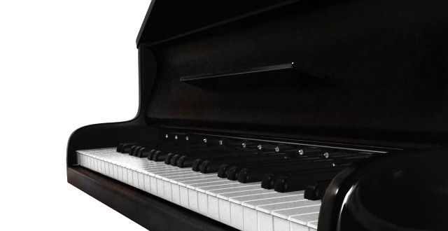

文章aniOcean1204 » 3日 9月 2009年, 01:55
加左hdri做environment. 感覺好似好左. 有d反光部分都系差左d
