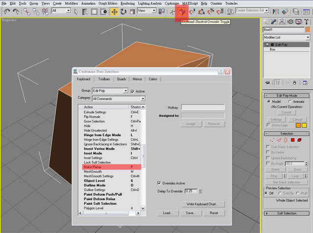

文章sivin1015 » 1日 9月 2010年, 10:57
3ds max problem
系object 到加左個edit poly
之後用shot key (eg. P etc)
個object就變左形
but 個view 就冇變,
有d 咩野set 錯左
可唔可以help me (好唔方便)
sivin1015
文章: 58
註冊時間: 16日 2月 2008年, 23:48
文章sobig » 1日 9月 2010年, 19:09
"P" is a short cut key for "Make Planer" in 3ds max when you are working with Edit Poly. That's why your model will be pushed as a planer when pressing "P".
there are two ways to skip it.
1. Go to Main Menu > Unclick the "Keyboard Shortcut Override Toggle". All shortcut will be removed.
2. Got to Main Menu > Customize> Customize User Interface > Keyboard Tab> remove the Shortcut of "P" under Edit Poly Manner.
Take a look of my screen capture.
hope this help.

文章soLost » 2日 9月 2010年, 00:06
