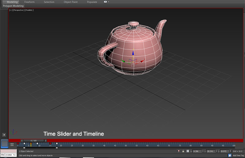

你好, 我想問一下我在做動畫時, 想方便一點做重複的動作時, 都希望用copy到keyframe之前的動作再paste去後面,
但是paste完的動作再play一次都沒反應, 我是使用auto key 來set的, 是不是我的setting有問題?
希望有大大指教, 謝謝!! :D

On the timeline, you can can select key frames that you want.
1. Press "Shift" on the keyboard >>> Left click on your mouse and drag it.
2. Once, you see some key frames are duplicated. Duplicated key frames will be white.
3. Release and drag the key frames to specific timing
4. You can do the same steps in Curve Editor as well.
5. In curve editor, you can select the key on the animation curve and duplicate it with the same way from the above.
Hope this help. good luck.
