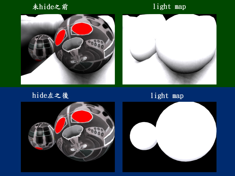

聽人講將個scene分開黎rend,之後合成會快d,但系要點做先可以分開rend??我用左skylight+light tracer+direct light,例如我想rend前面的波,我系咪應該hide哂其他野??如是者個波的底部就冇左light tracer的陰影!
如果乜都唔hide的話同平時rend的時間一樣,點先可以skip左其他野唔rend住而剩系rend當前的波??謝謝^^

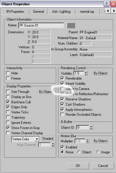

試試select 要hide o既 object,
right click, 揀 properties,
o系rendering control o個度熄o左 visible to camera.
o}-<

1. when u render the monster, you can uncheck "visible to camera"
then, you get the monster layer.
another character is also.
for the background, u need to uncheck those two characters"visible to camera".
if u use GI render, "visible to camera" is important..it seems that the character will be hidden. but PC will calculate your GI among characters and the ground.

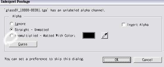

alpha channel is the transparency layer.
eg. you render your character layer that should have a alpha channel. that means the transparency background.
u should render TGA file.
when u import it into AfterEffect, it will ask about the alpha channel. then, u should click the third one.

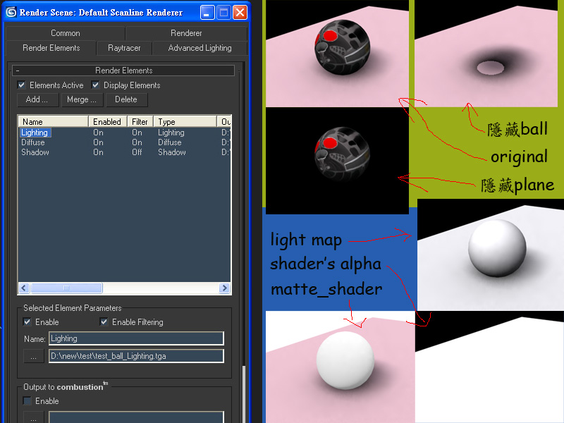

"GI"系咪要開mentalray先有?我用default renderer的,如果唔tick visible to camera的話都要rend埋睇唔到ge野,咁hide黎做乜??一樣rend咁耐~
for問題1:關左monster的visible to camera,咁monster layer咪冇左只monster?
2)系咪用render elements黎分開rend?
3)如圖,ball,plane系咪咁分開rend??之後用ae合成??感覺一齊rend同分開rend的時間差唔多,如果有兩件野分開rend咪用多倍時間?
4)個影可以分開rend嗎,而家系連埋個地一齊~系咪用matte/shadow
謝謝解答^^

文章sobig » 3日 11月 2006年, 00:53
1. 你唔系想分開兩個character render? 咁樣咪易tune色law..
2.正路系用render elements分開layer....有時唔需要太complex既layer...我會用唔同shader assign周一個object...再分開render.
e.g. color diffuse shader, specular shader and etc...
3.時間可能仲耐....分layer render目的只系方便在aftereffect tune 色...唔洗下下再render,
4.系...用matte/shadow...記住render時 invisible左個object...咁就可以render一張shadow layer.
