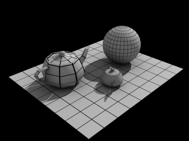

好像下面的那一張一樣?
又可不可以做到一張效果圖.只是某些部份是wireframe.可以嗎?

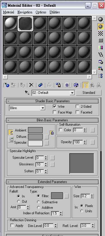

可以..
add一個wire shader...
如圖...click左wire check box就ok...
下面可以sett thickness

可以...不過好stupid 如果在3d做...
你可以用composite map/mix map做
用一個dafault shader加一個wire frame shader.
再用一張黑白mask,用uv map到你想有wire frame既位置.
你一定要3d做就系咁樣....
我會用aftereffect comp做...
可以自己out出想有wire frame位置 :)

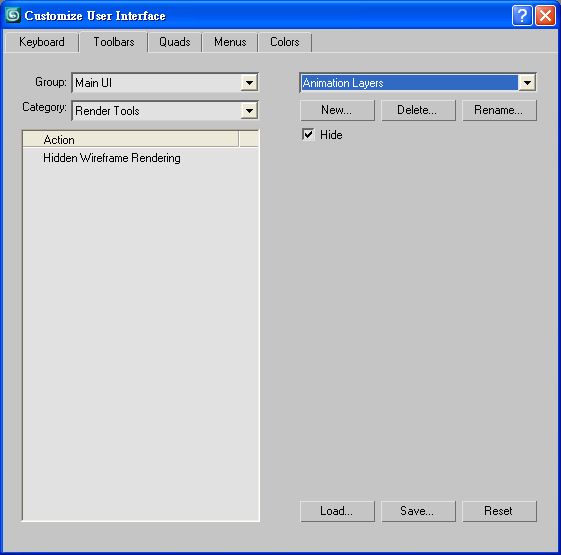

1. Unzip the hiddenwire1.zip file and put the .ms file in the Scripts folder of your 3ds Max installation folder.
2. Run 3ds Max, Open your scene file. Then open the .ms file in the Utilities panel > MaxScript > Open. Choose File > Evaluate All (Ctrl+E).
3. Right click on the Main Toolbar and choose Customize... In the Category dropdown list, choose Render Tools. Drag and Drop the "Hidden Wireframe Rendering" item onto the Main Toolbar. A new button will be formed on the toolbar.

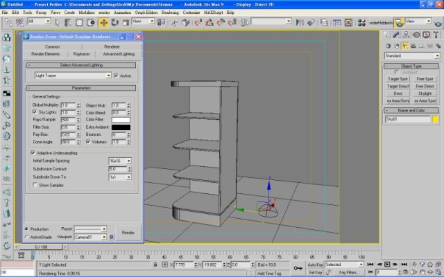

4. Add a Skylight into the scene.
5. In the Rendering menu, choose Advanced Lighting > Light Tracer. Fine tune the settings as you wish (or just use the default settings first).

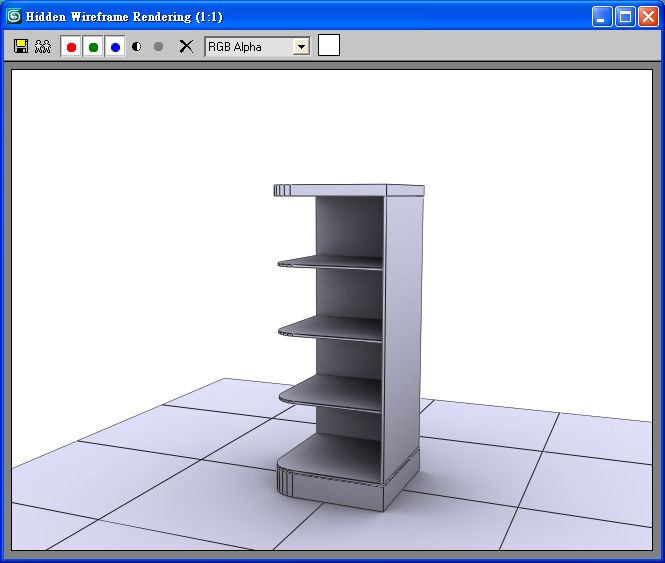

6. Click on the RenderHiddenWire button you just made and click on the Render HiddenWire button on the HW v1.0 dialog box. This Maxscript will render the material of the objects and also the wireframe (using the wireframe color, so you may want to set the wireframe color of all objects to black).

Use Skylight together with Light Tracer to create the GI effect.
Resulting rendering.
