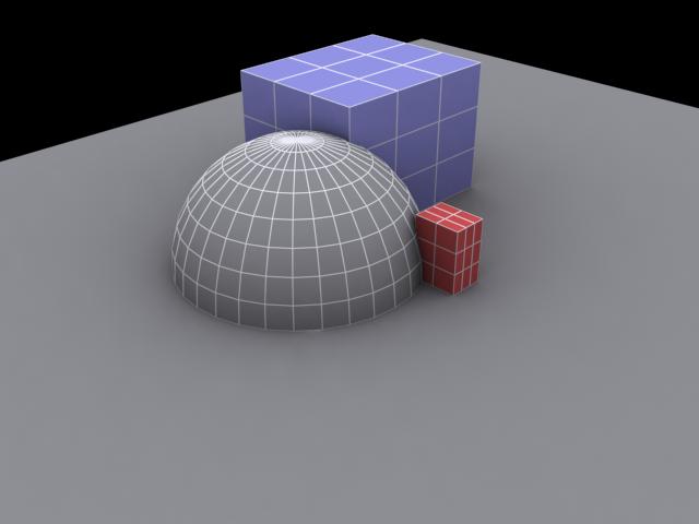

Here is a simple way to do it without Photoshop/AE or scripts, render directly from Max.
"Clone" all objects as reference and apply a "push" modifier to them, set the value to 0.1 or so. Apply a wire material to them, then render as usual.
Wire on top

文章sobig » 25日 11月 2006年, 00:05
大佬好野....
不過唔系好明...
做唔到 :)
文章stantang » 25日 11月 2006年, 12:51
sobig 寫:....不過唔系好明...
做唔到 :)
Select all your models, use the clone function to make "reference" objects. With the "reference" objects selected, add a "push" modifier to all of them, use 0.1 or lower as the push value. With all the "reference" object still selected, create a wire material, uncheck "2 sided" and apply it to all the "reference" object. Finally, just hit render.
