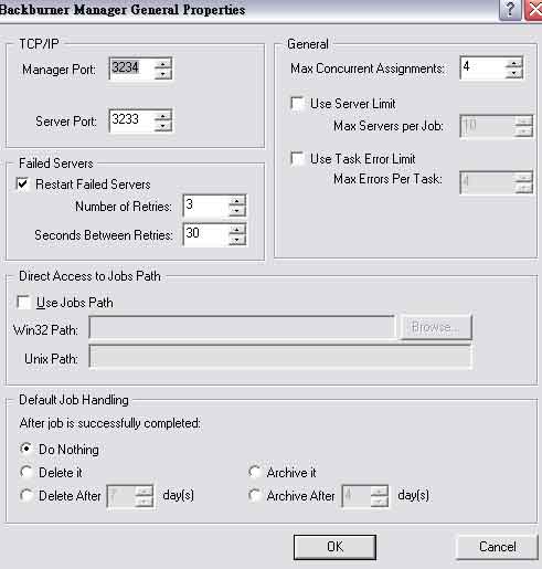

1. Program file>Autodesk>Backburner>manager
then you will see this window. you can see your local(Manager Port) ip and server ip and etc.

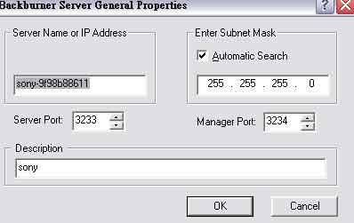

2. Program file>Autodesk>Backburner>Server.
this step means your pc is ready to receive render job from your local (manager port)pc.
sure, you can do this step for both local and server pc.
you will see this window that can set your server ip.

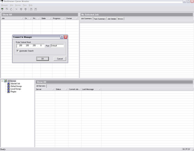

3. Program file>Autodesk>Backburner>monitor
this window is to view your render jobs that you submit b4.
you should see your job lists here if you submitted your job.
before you view it, you need to press "connect" to connect your server pc and local pc. the green button is on the top left corner.
sure, you also set the server ip.
