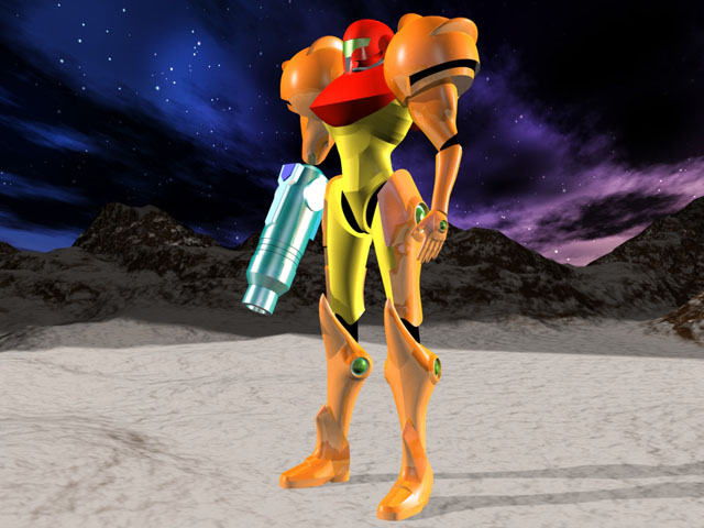

我第一份功課,想大家俾d comment, tks!
文章siub » 17日 10月 2007年, 18:42

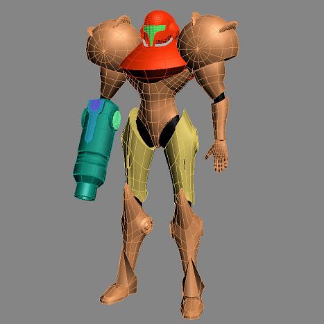

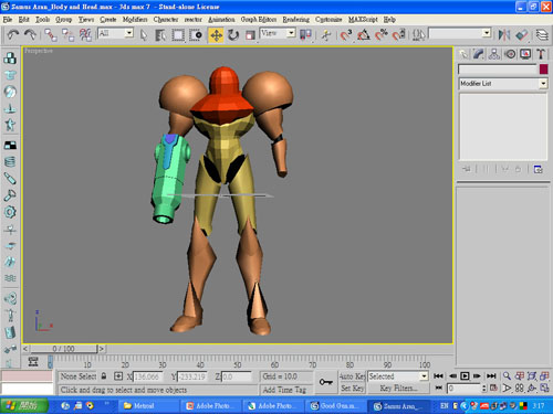

第一份功課系要求用基本既object + 教過既modeling technique去起個機械人model.唔使落texture & material.
由於起完model仲有時間,所以想做多少少. 睇左d tutorial做左個雪地, 同埋啱啱教左小小set material,所以都試下改左d diffuse colour, specular同glossness, 而打燈就未學,唔知點樣可以做到想要既效果.... texture亦都唔系好識,所以做唔倒機械人上面d紋理.... :(
就快要交啦,我好想知道自己做成點,希望大家盡量俾d意見,仲有時間可以改,想做得好d先交... :D
thanks!!
Reference
Progress 01
Progress 02
Latest Progress

文章sobig » 17日 10月 2007年, 23:47
could you post your materials setting here?
i guess the issue is the material setting right now.
other things look fine to me!
文章h2o » 17日 10月 2007年, 23:50
爆爆地.... 燈太光 or material 吸太多光 :roll:

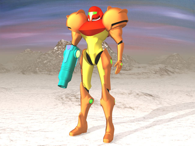

文章siub » 19日 10月 2007年, 11:32
謝謝sobig & h2o既意見 :D
material淨系set左:
Metal
Specular 235
Glossness 35
響周圍平均咁放左三盞燈(area omni),無攪過裡面d settings. 尋晚啱啱教左3 point lighting. 之後會自己再試試
其實點可以做到metal有少少shinny同反光既感覺? 另外,個槍咀點可以做到發光呢?
siub

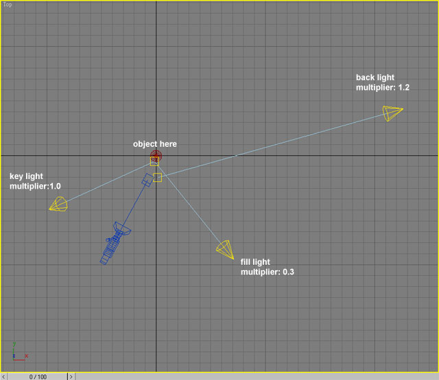

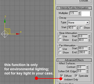

文章sobig » 19日 10月 2007年, 15:59
for your 3 point lighting,
i suggest you can use 3 spot light rather than 3 area omni light.
area light is mainly for environmental lighting.
1 area light is enough for that if u want to use.
following is my idea of 3 point light in max.
of course, the multiplier is not a core.
it is just a brief comparison among those 3 light.
you can chance it depend on your sence.
hope this help.

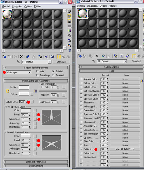

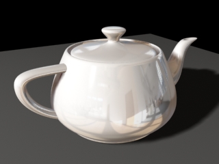

文章sobig » 19日 10月 2007年, 16:27
for your metal material,
here is a example and the material setting for u.
the major issue is playing arround with the reflection.
for sure, you can change it whatever you want.
it is just a fundamental material for u.
i can email you the max file.
wish this help.

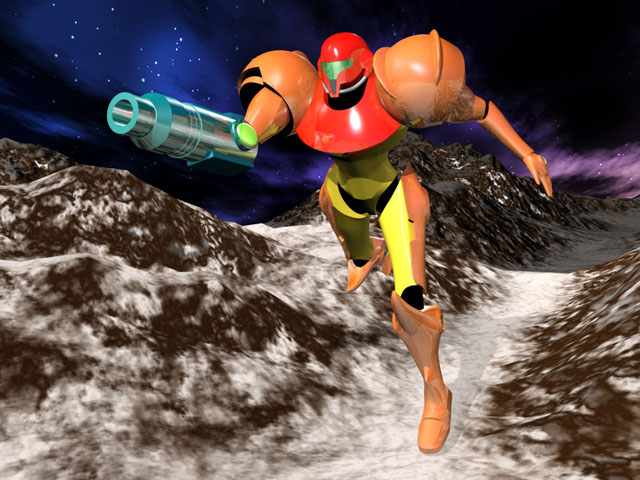

文章siub » 20日 10月 2007年, 12:02
Thanks sobig. You are so kind :)
I have played around based on your given settings. It looks much better now. But now the metalic material look rather like the painting style on car with clear reflection.
If I want to make it like brushed metal (i.e. with hair strip pattern and much less reflection), how can i achieve that?
Beside, I have tried to search the "glow" related topics, but it involves some other unknown terms like "output event", "video post" , "rla file type", etc...... So I guess I need some more time to understand that.

文章sobig » 21日 10月 2007年, 00:40
no worries, mate.
u get the job done. very well :)
brushed metal:
http://www.3dtotal.com/team/Tutorials/brushedmet/asberg_bmetal_01.asp
car paint material:
i suggest you can use Car Paint Shader in Final Render Stage-1 2.0 for max. fast and easy
http://www.finalrender.com/products/feature.php?UD=10-7888-35-788&PID=36&FID=549
pm me i f u want to get it.
