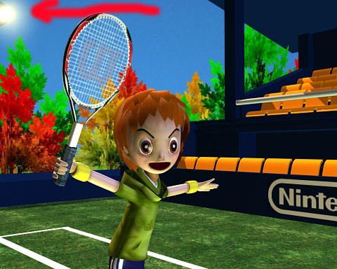

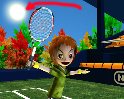

我用個sphere加左glow做太陽,但系點解當個太陽成個響畫面時就正常.但系當太陽只系show一部份時,個glow就唔會包住整個太陽.. (如圖),何解?
正常情況
tennis 01.jpg (93.25 KiB) 被瀏覽 7700 次
畫面只見倒部份太陽既時候,個glow就唔會包住整個太陽..
tennis 02.jpg (95.05 KiB) 被瀏覽 7703 次

i guess your omni light is not located as same as your sun object.
Lens effect>Glow is activated by light sources like omni, spot light and direct light.
you should use Glow without the sphere object.
Or, you can do a Glow effect by setting up a Object ID.
then, your sphere can be a light source.
Glow Element> Options>Image Sources>Object ID.
Object ID = your Object ID from your sun sphere.
文章sobig » 9日 2月 2008年, 21:32
mostly, we do the sun glow in AE.
you can render a B/W mask, then you can add glow effect by this mask in AE. easier to control.

I set the Glow to the sphere by the Object ID way....
I found that when the sphere cannot show completely in the screen, or it is partly blocked by something with "透 alpha", the Glow may not work correctly.
I will try to figure out how it work in After Effect then. Thanks.

始終 glow 系一個 post effects, full size or 見到部份, 都會影響佢 calculate 既面積, 3d 做一定差d
就算 after effects 做都系, 通常會 render 個 size 大少少 or 用其他 filter track 番個 movement :wink:

都系覺得render 多個mask 之後comp 上去方便d哩。
如果個cam movement唔多....人手畫個mask重方便。
反正大陽都系圓形o者...
