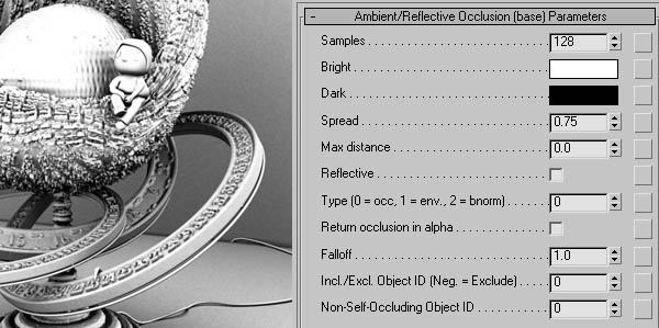

然後就系加入 mental ray o既 ambient occlusion.
至於ambient occlusion 系乜o野就睇哩度
http://www.cg-forum.com/main/viewtopic.php?t=5773

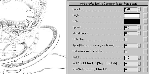

小弟利用ambient occlusion 做o左兩個layer,
一個比較soft,用o黎加強整體o既融合,
一個硬淨o既就用o黎加強detail位,接合位o既陰影.
下圖系兩個layer o既create 方法,
主要分別在於soft 無限制max distance,
而hard 系有限制max distance.
soft occ layer setting
hard occ layer setting

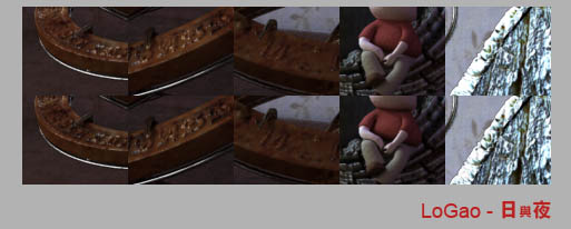

首先系將 hard occ layer 放上面,
將display mode 由normal 轉做 multiply 就ok.
(當時可以調教opacity o黎調整shadow o既厚薄)
本來形狀模糊o既細微地方會清楚細致o左,
甚至帶出更多detail.
細微地方o既分別,
模糊o既細位變得實淨.

soft occ 同hard occ 系一樣o既使用方法,
都系display mode 由 normal 改做 multiply.
soft occ 令畫面內所有物件之間出現自然漸變o既灰色,
大大增強物件之間o既位置感同距離感,
比起之前主體同背景融合得多.
物體與物體之間o既光暗漸變變得自然得多.

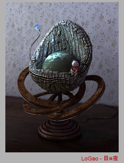

文章sobig » 25日 10月 2006年, 14:14
i think you can render a specular layer for the lower part of your lamp. then, u can increase the specular level that boost your shape of your lamp. i knew you want the bulb to be the focus point. however, you can slightly present your lower part by sharp specular. what do u think ? :)
for the bulb color. i prefer green or orange rather than blue. blue is cool tone. u want to make a natural mood, right? green and orange can be the good choice to your aims. will u put it in a child room? i think they like orange and green lighting :)
your clay doll is so nice. will you render a SSS layer over the clay doll in compositing. then, you clay doll will like great.
文章LoGao » 25日 10月 2006年, 15:06
sobig 寫:i think you can render a specular layer for the lower part of your lamp. then, u can increase the specular level that boost your shape of your lamp. i knew you want the bulb to be the focus point. however, you can slightly present your lower part by sharp specular. what do u think ? :)
MCVS02 過o左,我應該都唔會再執哩舊o野o架喇,
底座加specular layer 勾番個型出o黎,
同埋泥膠公仔o既sub-surface 都系好提議,
不過我唔系好識搞sub-surface,
要等你o黎教我喇.
燈光方面,雖然綠光或者橙光系配合到"原始"o既主提,
但系哩個始終系個鍾,而且叫做 日與夜 .
o個盞燈就系 日 夜 交替o既重點,
所以我都系會選擇番藍光代表夜晚,
日頭會系黃光,甚至無光,
因為燈泡o系日間發揮唔到咩作用.
拜謝"嘩!好大"o既意見 orz
