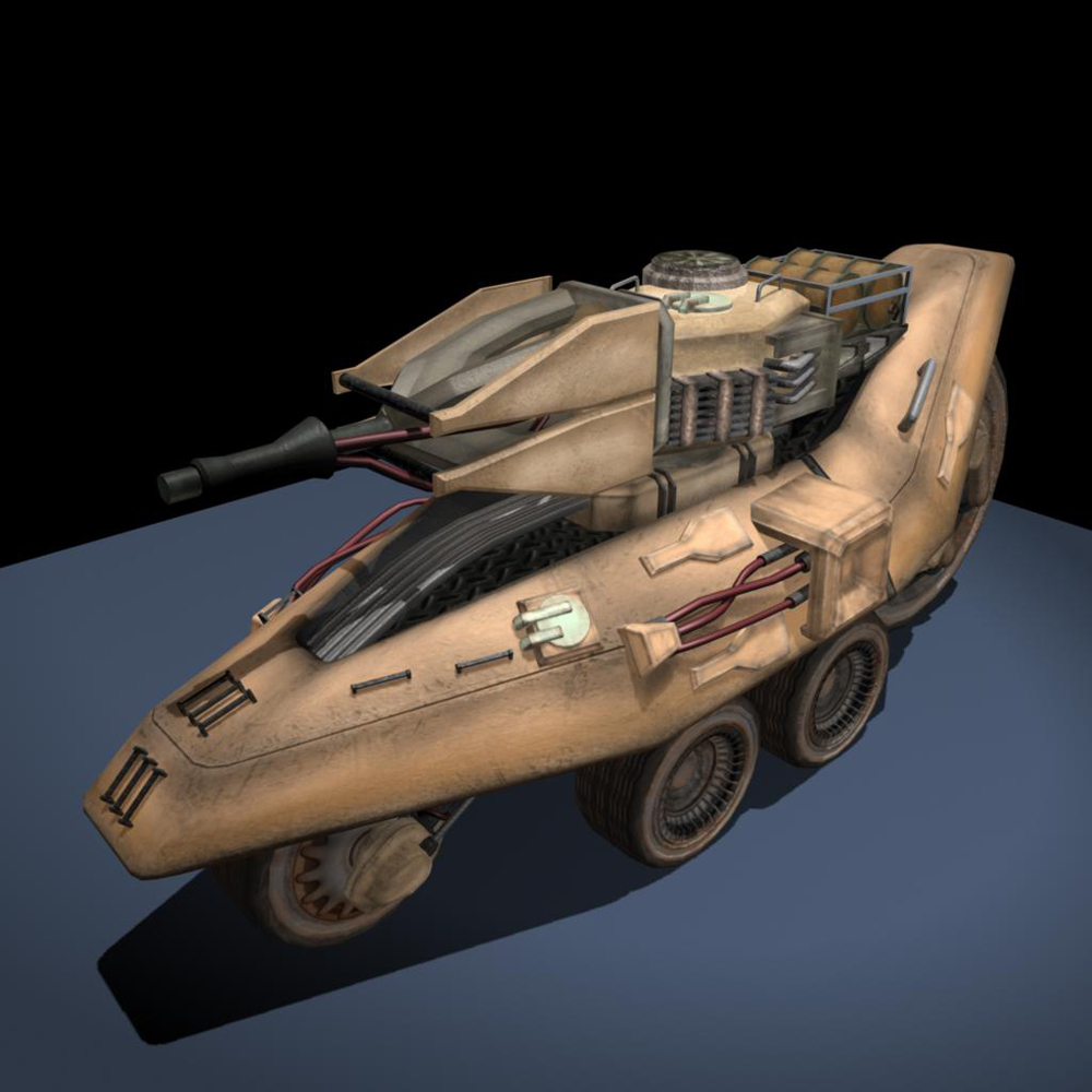

小弟用Maya正.....可以比意見嗎 :D
文章ziffrey » 6日 10月 2007年, 19:46
:D

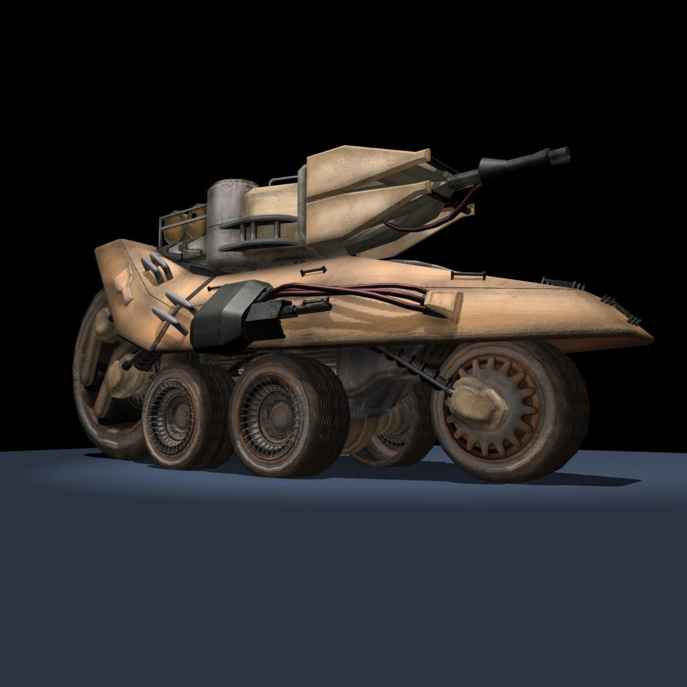

文章stantang » 6日 10月 2007年, 22:03
The design is pretty unique. My suggestion is to improve the shading of the tank, if the tank is made of metals then the shading should have specular/highlights and higher contrast, try use blinn or phone as the base. Your must have an ambient light in the scene that makes everything look flat and un-interesting. try start with a basic three point light setup. Some textures seems stretched and not detail/sharp enough, you might want to pay attention to that as well.

文章ziffrey » 10日 10月 2007年, 22:48
:D I will improve the lighting and texture ,i just use two ambient light in the model top.
Sorry,i don't know where three point can do (a basic three point light setup) :cry:
Thank you very much :D
