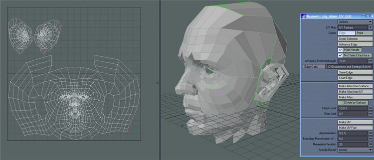

文章moc » 16日 7月 2006年, 18:47
(可在7.5上用,當然8,9也沒問題)
是的...完全免費...其實跟unfold完全無關....
是一個日本LW插件高手自己寫成.....
http://homepage2.nifty.com/nif-hp/lw_pl ... v_edit.zip
這個作者很低調......
其網位一並放了好幾個其他好工具.....
會看日文的人可以去看看.....
當中還有兩個跟IK有關的.......
這個日本高手除了這個UV tools外...同場還有一個Relax UV工具及一個simplify mesh(其實就是一個把高密度模型簡化qessloss的工具.......不創新但速度很快......)
在NT討論區有老外研究到這個免費UV unfold原來還有著一個手法......
原著是:
Ummm, actually, if you use the plugin's point mode, you can select the first point of a seam with the LMB, then click further along the seam with the MMB and it'll try to work out the most direct route between the two, making it very quick and easy to mark your seams. I find this quite quick, although it'd be perhaps handier to be able to store the seam in a selection map.
