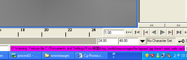

文章story_koo » 14日 5月 2008年, 15:58
小弟用maya8.
好多時貼左圖
關了maya後
下次再開返想約繼做時
之前貼的圖,全部都話link不多
點樣可以不用再由頭link過呢

Seems like you're using some absolute path instead a relative path. and you have one more "\" before "sourcimages" in the path name. Try change your path to something like "sourceimages\XXX.jpg" instead. If you set your project right, the texture should load up without problem.
The other thing that might cause problem but I'm not sure is the chinese word in your link. May be Maya doesn't like that... I don't know since I never used Maya in Chinese windows. May be h20 can answer.

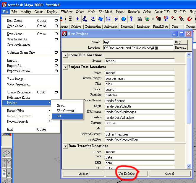

文章h2o » 14日 5月 2008年, 21:48
中文 同 space 都會有問題..... 視乎用咩 renderer or mel scripts......
最好 keep 習慣用 underscore 代替 space :wink:
p.s. 你開新 project 時 or 做 mapping 前要 set 好 project, 唔系 map 左之後先 set

我每次開新project都會 new一個project,同用佢defaults 既setting.
開既時候都會set 返個project先....

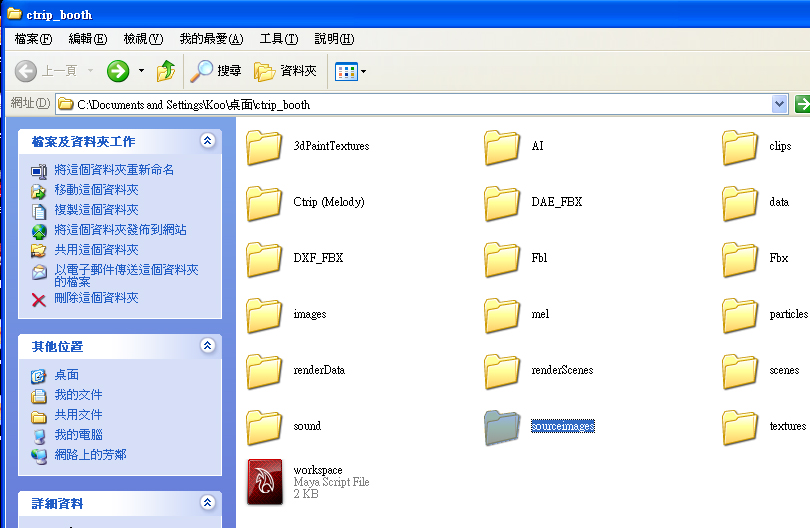

文章kuykuy » 15日 5月 2008年, 10:16
試下唔好set個project在桌面, set在其他唔會有中文字存在的地方, e.g. c:\project
