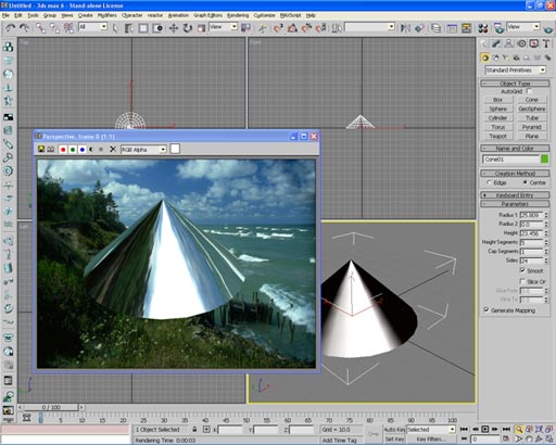

specular must set to very high, specular decal must be small. get 100% reflection. make black to both diffuse and ambien. you'll get it.
oh by the way. besure to make a specular map. get som finger prints, water marks.
but yes, you must post something for us to tell u what to do.

The container should have alot of metalic look of it. So maybe you add some noice into the shader. but don't put any reflection on the container. Because specular should be good enough. and.... yap
follow my settings
Get a blinn shader
Diffuse=black ambien=black
Specular lvl:1000, glossiness= 50
turn refletion on at the map sections
get an envirnment map and hit render

don't just follow my settings. Well i mean you can follow it. But you must understand why do i put the settings.
Most of the metalic object should use Blinn, Because it calculats the specular value different from the general phone shader. However, blinner shader is not good for doing car paints. Anyway, you are doing metalic object so blinn should be good enough.
Keep in mind that the diffuse colour is opposite against reflection. So that if you have 0% of reflection, your diffuse should be 100% white. (which will never happen, because all of the object in our surroundings must have reflections. Otherwise we don't see that object). In other words, if your object is 100% refective, the diffuse should be black. So that i put black on the diffuse in this case. And ambien, you should keep ambien as black at all time. Ambien means the area which lights don't hit. So if the light doesn't hit that area, technically meaning black.
Specular is very important. Notice that metalic object should have no fall off in the specular. So you must need a sharp sharp specular. After setting up the diffuse ambien and specular, you put 100% of the reflection. then thats it.

Notice that reflection must give something for it to reflect. In our real world, all kind of surrounding can reflect into the object. But in the default of 3D world is black. So logically the object will just appears tobe black. Make your world white, the whole thing will appears tobe white.
So, either you make a lot of object in your scene for it to reflect or apply an enviornment map for it to reflect.
