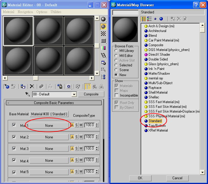

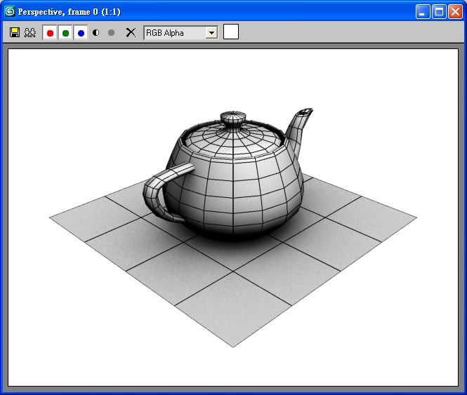

(以下方法要用Max9做)
Make sure you are using Mental Ray Renderer.
In the Material Editor, click Standard and change it to Composite Material.
Click the None button besides Mat 1. Choose Standard.
Assign an AO map to the Diffuse channel.
the amount of Samples affects the quality and time of rendering. Click Go Back to Parent afterwards.
Click the None button besides Mat 2. Choose Standard.
Check Wire. Choose Black as the Diffuse Color. And for me, I will set the Self-Illumination to 100 to avoid the variation of the wire color due to lighting conditions.
Assign the Material to the objects and make a rendering.

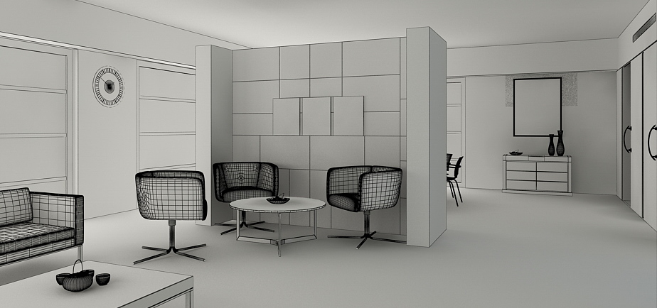

我做左兩個,一個室內既應該系你想要既效果,另一個系我以前做既一個項目(F1),入面用到呢種效果,不過就系淨系得wireframe,其他會透明既
不過我都系用VRay render既,用VRay有距既一個好處
如果你覺得效果滿意我再詳細講你知點做丫, :)

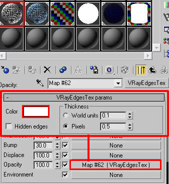

首先要install左個VRay先拉(廢話),然後select一個VRayMtl base material,系距既Diffuse map 裡面加入VRayEdgesTex,如圖所示

上面如果base material吳選VRay專用既都可以用翻Standard既,只要系Diffuse map裡面加入VRayEdgesTex就得(前提是一定要先選擇VRay渲染器)

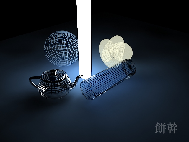

體下測試效果拉,不過做伊種效果個Antialiasing 要開得比較高D線條先會清晰吳會斷,伊張測試我系用Adaptive sudbivision 既Image sampler,Min.rate/Max.rate=2/4,一般如果要出產品級既效果就3/6啦

如果想出只有線框既效果,只要將剛才material裡面既VRayEdgesTex從Diffuse drag to Opacity就可以拉,不過要記住將color變成white,而且只要你稍作思考,就可以做出一D其他既效果 :wink:
