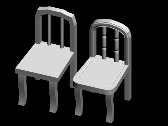

上傳試作版椅子以供參考~:
左邊的low-res...用了103個 polygon,
右邊的起角所謂high-res版 就用了1190 個polygon!!

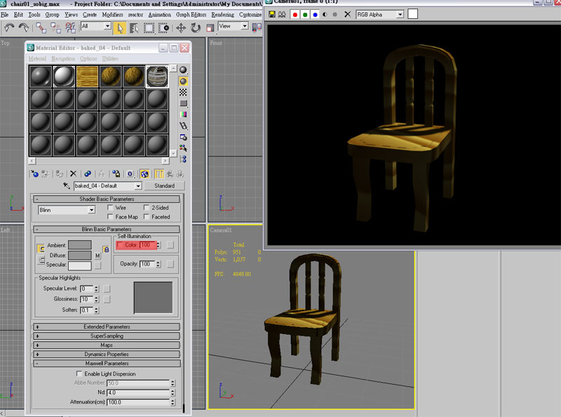

將個low res model打哂燈, 再去main tool bar>Render>Render To Texture. export一張有pre-lighting既texture(哩張新texture已經有shadow,lighting), 再map返本身既model.
game reflection系 base on你 game engine既支援
我之前舊方法做過系,只需要map張noise 落reflection. export左model...在engine就可以扮到reflection..不過依家d engine咁勁, real time motion blur, hdr...乜都有...
我用左你個model做"bake"俾你...
1. select your model, go to Render>Render To Texture
2. under the Output rollout, click"Add", choose"CompleteMap"
3. Target Map Slot choose"Diffuse Color"
4. choose resolution and path for the Bake Map.
5. press"Render" , the model will generate "Automatic Flatten UVs" modifier.
6. get the Bake Texture by "Pick Material from Object" in mateial editor.
7. apply the Bake Texture to your model, set the self-illumination to "100"
8. press"F9", you can see the final image.
PS. 你可以search" bake texture" and "normal map" in max tutorial. 有個好詳細既tutorial講解..hope this help.
attach左個file俾你....take a look.

有圖俾你睇睇
