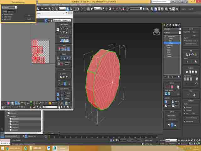

Hi, all. I am new to this forum and have the following question:
Do anyone knows how to properly unwrap the bolt I attach?
Many thanks!

The tutorial is wonderful. However, it still can't solve my problem.
I have tried used Box Mapping under Normal Mapping, Edit Seams and even Cylindrical Mapping methods, but the the problem persist on the sides on the bolt model. The UVs over there are still not very ideal.
Do your guys have other suggestion?

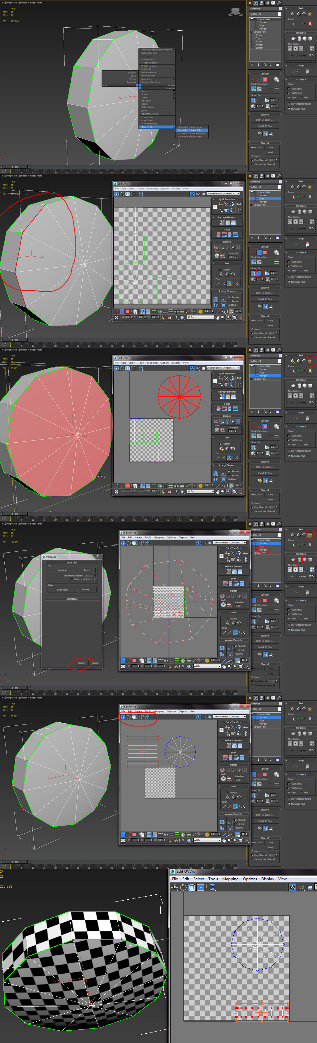

For your case, here're the screen captures.
1. You can reset all the settings by "Convert to Editable Poly"
2. Assign UV Unwrap to model and use of "Point to point seams"
3. Make sure you edit your UV in vertex mode if you are using point to point seams.
4. Good use of "Pelt Map" under the Peel category. Normally, you can choose"Commit" in the simple UV"
5. Edit the UV scaling and proportion in Free form Mode.
6. We always assign a "Checker" map into the model in order to preview the UV scaling and connection among each single UV element. (two UV elements in your case).
Hope this help. Good Luck!!!
